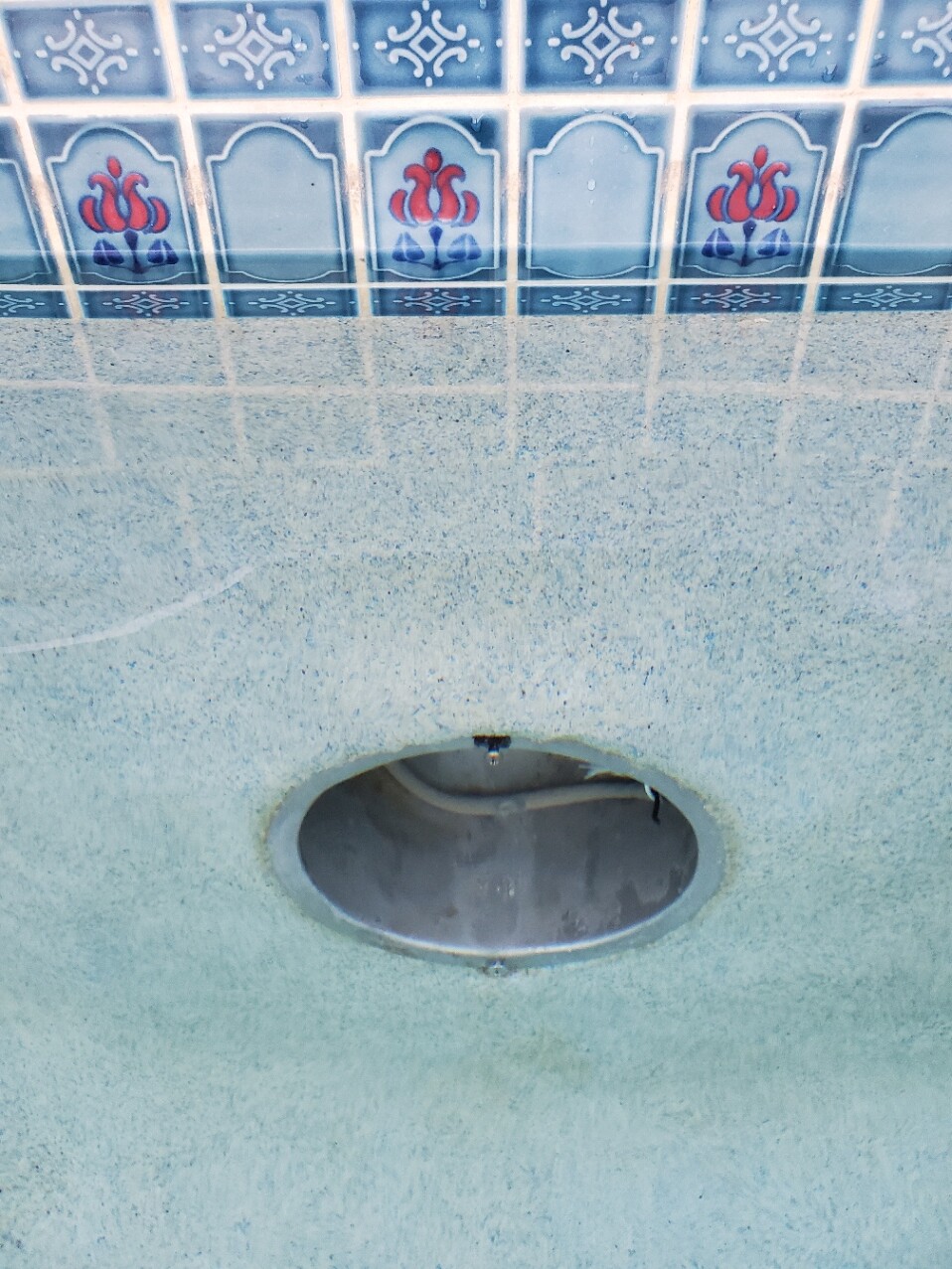

Similar to an earlier post by Kimberly410 back in 2017, I find myself needing to replace a Hayward light. The unit appears to be a SP-540 and the niche is SP-555. The recommended replacement in 2017 was a 500w 120v Duralite with a 50’ cord model number SP0573LN50. Unfortunately, it appears that model has been discontinued. Is there a newer model that I can use with the same niche?

So, I have ordered both the Aladdin 500P and the 500C, and without the use of a hacksaw or blowtorch, neither one appears to be the solution. Both adapter rings are too wide to fit the opening of the niche, and neither ring allows for any adjustment. If I bend the plastic on the 500P, I can force it into the hole, but it won’t stay there.
For sizing purposes, the two screws are 10" apart, which means the ID of the niche is less than 10". According to the Aladdin Catalog (see page 21), none of their products will fit.
For grins, I’ve added two additional photos. One of the ring installed witout force (see ovehanging plastic piece), and one of the ring forced into the niche. I will be returning both rings.
